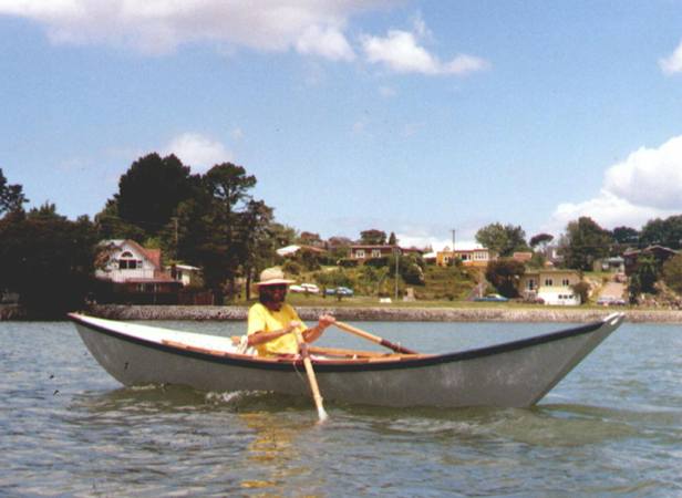

I can carry the boat on my own, essential for a boat that will be used almost entirely single handed – she weighed in at 42kg dry.
She rows extremely easily, better loaded than light because of the heavily rockered bottom. It cannot be driven past hull speed even by a very strong person but is wonderful for eating up the miles at a moderate pace. I've covered 3½ measured statute miles in an hour without busting my boiler and have travelled 25 miles in six hours with tidal assistance.The light weight and the narrow waterline beam combine to make the boat feel a little tender when unloaded, especially when the rower is unused to the wiles of dories. I carry about 30 litres of water in plastic jerry cans which improves her stability and also helps the boat carry its way.
Like most fine ended boats she is pretty sensitive to trim, if I find she needs to be a little bow down to stop her blowing around broadside on while I try to row her to windward, or conversely, stern down for downwind I have a ten litre plastic container of water on a light line and toss it to the appropriate end of the boat The line is so I can retrieve it without moving from my secure seat amidships.
A full load of camping gear and provisions makes things easy, the boat rides better down on her lines a little, and she is much more stable. Rough weather in one of these is exhilarating. The motion of the boat is very easy, especially in a beam sea when the rowers position right on the centre of motion about which the boat pitches so the oarsman doesn't get thrown about in a seaway. It is amazing to watch as great foaming crests disappear under the gunwale without any fuss.
